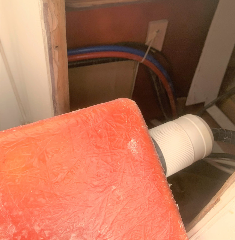

I wanted to share what I found with the community. If you have an early 2000s Carver 396, the water that feeds the rear head come from the kitchen and raps around the back of the boat. You can access the water lines by removing the recessed electrical box at the bottom of the swim step ladder. They are 15mm lines so you will need to get an adaptor in order to connect shore water or a wash down. Interesting side fact is that my boat does not have the second 50 amp power connection but the wire is present and runs back to the breaker box.
