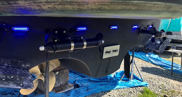

for what it is worth, I didn't want to spend a lot on the underwater lights because I wasn't sure if it was just a novelty that would eventually just not get used. I decided to take a chance on the Husuku SOOP3 lights from Amazon https://www.amazon.com/gp/product/B088GYJFP2/ref=ppx_yo_dt_b_asin_title_o06_s00?ie=UTF8&psc=1. They are really bright on land, and pretty good under water... I would say not as bright as the ones above.... Drilling the hull wasn't a huge issue... Famous last words.... I think it was an 1/8 hole to feed the wires though. The lights have a built-in rubber gasket, but I also used Sikaflex 291 and made sure I had a good squish.
I also used a wireless control unit that has a key fob so I didn’t have to try and fish wires up though boat. This thing works great! https://www.amazon.com/dp/B07JFH6VQH/ref=cm_sw_em_r_mt_dp_5SKNTXJR172NPYW381P0?_encoding=UTF8&psc=1
Here are some install pictures so you can see how it turned out.
