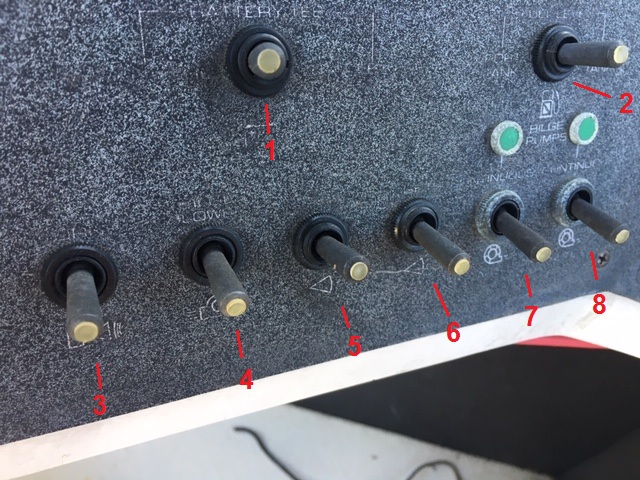

Hey guys!! I need your help again to identified some of the switches on my dash/front panel of my 1989 Santego, thought I would find that in the owners manual but no

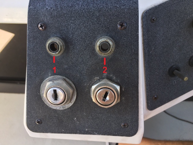

On this first Picture, what belongs in the two holes above the ignition keys?
Second pic
