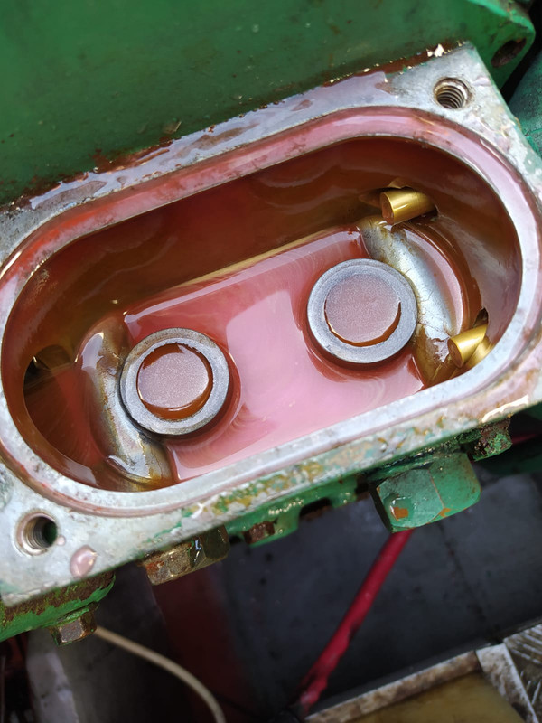

Well, here is another happy update: Today I opened the thermostat housing and there was:
https://i.postimg.cc/1tTQk6bq/Whats-App ... -49-21.jpg

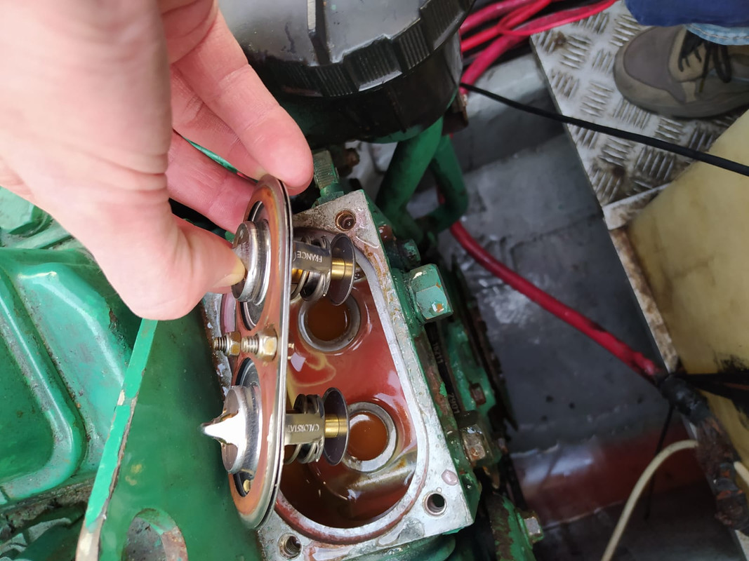

No thermostats! So that explains the cold engine at all times. So I put in the new ones:
And we took it for a trip and both engines nicely kept their temperature around 80degrees Celcius.
Powered them up and reached a comfy 25mph on flat water. On the return run, however, the cap of the expansion tank popped off and it spit out a gallon of coolant....
Fixed the cap, filled the coolant (lucky I had that aboard) and calmly went home. No further problems.
