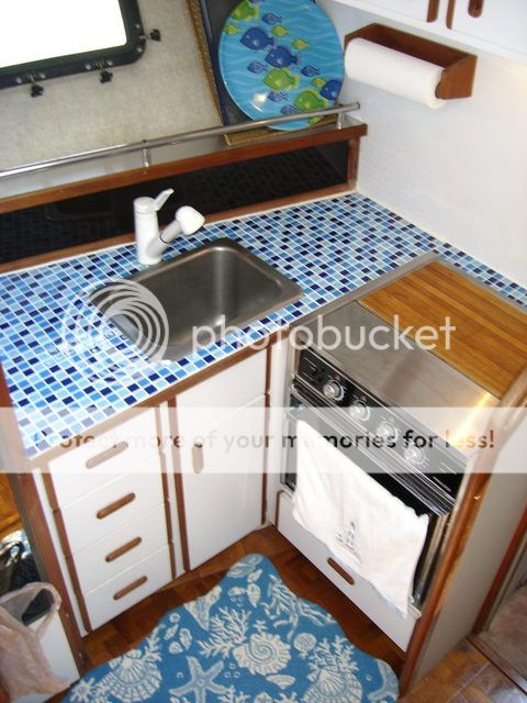

In our project, I pulled all the old hardware (sinks, stove, vents) out, had my granite guy template for the new sinks and things, and simply stuck the new granite on top of the original counter.
Did this in the galley, the head, and the bedroom. Also up on the bridge.
Came out great.
Added a few pics.
You do not have the required permissions to view the files attached to this post.

I went a similar route with glass tile over the original material. Not a really difficult project and solid stone or some other materials can get very heavy.
