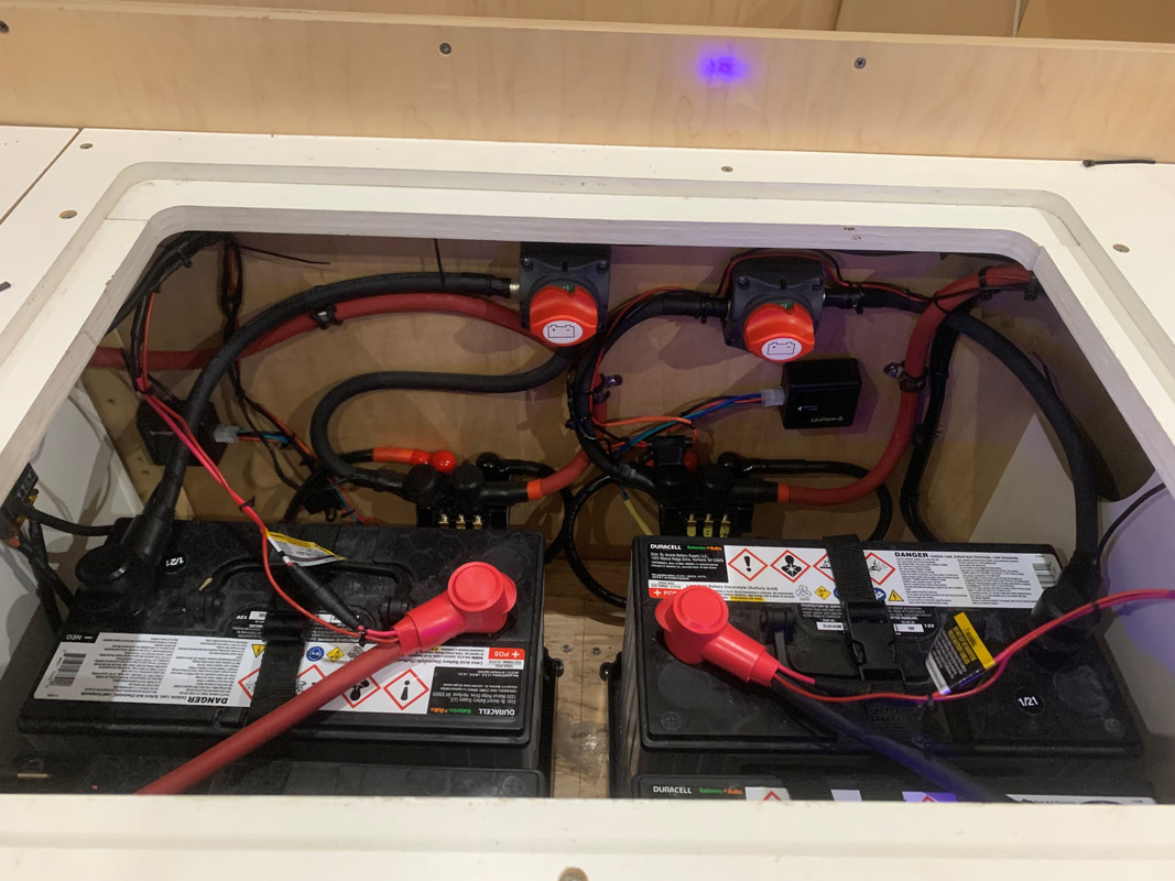

My new to me 2000 Carver 396 came with a Side Power 12v bow thruster which for most situations was adequate for docking, but the marina we are in has strong wind and currents, so I decided to add a stern thruster. This boat has extremely limited internal space at the transom so an most brands of thruster would not work. I opted for a dual 24v SideShift ST350 configuration to limit the needs for interior components.

Wiring was a challenge. For the thrusters was a challenge, mostly because the instructions are a little too simplistic. Key take away if you decide to put these units in yourself…. This unit is controlled via the ground side of the circuit rather than the positive side. The diagram shows the ground wire from wireless receiver going to “common ground”. I connected it to the negative side of the battery which feeds the system and it did not work. I had to sleep on it to figure out what was wrong. The ground wire MUST! be connected to the ground lug of the motor control unit for the single to work. Here is my configuration. I ended up drawing this for the tech support people at Sideshift because of what I will explain next.
Days 3-4, Wire it up and try and make it look nice! (Don't forget trouble shooting....)
After everything was done the controls did not work. They were supposed to be factory programmed, but they were not.… I am not sure if I did it during the install or if they were not programmed when I received them. It took several conversations with them to get it sorted. If you hold the bow joystick to the right while connecting power it clears the programming. Their site has reasonably good instructions for single or bow and stern thrusters…. Murphy’s Law…. They didn’t work for me, because I have 2 stern thrusters and a bow. Here is the link to the instructions for single bow and single stern. (https://3bs9qa1fgvxs28kkjc10h4u9-wpengi ... -Stern.pdf) . If you have dual stern thrusters, follow the same process but instead of holding the bow joystick to the right and pressing the power button to program the stern, hold the stern joystick to the right and press the power button. This is not documented anywhere.

Oh, forgot mention. If anyone wants to do this type of install on a 396, there is enough room under the bed in the aft cabin. You just need to make sure you use AGM batteries.
