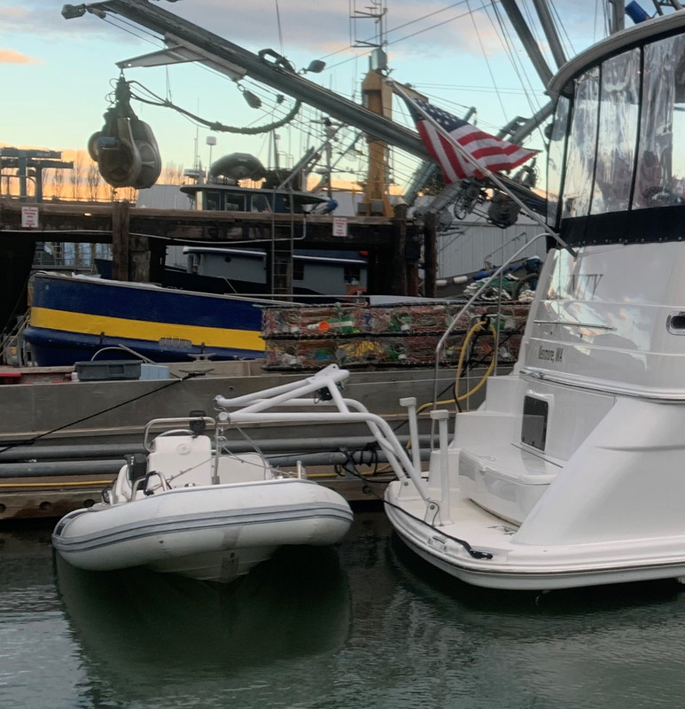

My 2000 Carver 396 has this tilt up davit.
When I purchased the boat last summer it had a 8' rib with an 8hp merc. It was in terrible shape so I found a 11' Rendova with with a 25hp Honda. I picked it up and I have been really happy with it. One issue.... I didn't even think about weight. It is exceptionally heavy. It is difficult to say exactly what it weighs because Rendova information is difficult to find but my estimation is about 700-750lbs wet weight.
This isn't mine, but it is the same tender....
https://boats-from-usa.com/sites/default/files/boats/not-specified/127921/not-specified-1454671.jpg
The davit had an old 1500lb winch on it so I replaced it with a champion 3000lb winch from amazon and replaced the 3x4 stainless backer plate with a 9x19 1/2 aluminum plate to take some stress off the back wall of the boat.
After only 9 months the clutch failed Dropping my tender 3 feet and then dropping the winch into the salt water. I am going to replace the winch but I am not sure what to buy. Does anyone have any a suggestion on what I should buy and what size?

I found a little better picture and included it below. The winch is mounted on the davit and the cable attaches to 3/8" stainless ubolt on the back wall of of the boat. I have beefed up that ubolt with the large aluminum backer plate I mentioned above. The winch does hold the dinghy up while under way. Generally I have just put a ratchet strap around the davit connected font and rear to keep it from swinging. I also have a stainless steel safety cable connected between the davit and the eye on the back of the boat. It doesn't carry the weight though....
I could let the slack off the winch and put pressure on that stainless cable, but it will have slack that may let the davit bounce...

I guess I am just saying that you should remove the weight off of the winch while storing it and underway. It will be easier on the clutch. A new winch similar to what you have will more than likely work.
As for your ratchet strap. I have always thought that they were strong until my previous dinghy was hit by a rouge wave and snapped two ratchet straps that I used as secondary attachment like string after the weaver yoke pad separated from the dinghy. I prefer to use dock line as a secondary lanyard to secure my dinghy now.
I do like your Davit system, it appears to lift your dinghy up and out of the water. Not too many options for a 396 with a factory swim platform. My 44 CMY has the same issue.
