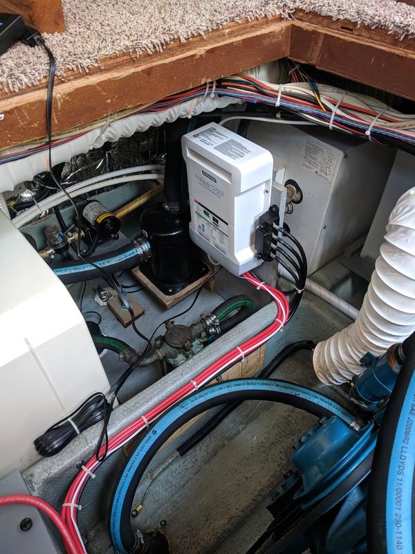

Thanks everyone who replied! I have finished my battery/charger project. I would love to post some pics, if someone could tell me what free 3rd party hosting I could use? I have google drive and google photos if I can use those to host some pics.
Here are more total costs and material used. TOTAL costs were. 1316.50 :-O :help:
4x Trojan T105 $658.56 (I have 7 12v car/marine batteries of various sizes for cores) donated by friends :)
Promariner 12/50p $394.56
Promariner remote $75
BUSBARS - 4-Post Power Distribution Block - 5/16" Black $21
Stinger SPF5660 Shoc-Krome Maxi Fuse 60 Amp 3-Pack $6.99
Ancor 252140 Butt Connectors (6-Gauge, 2-Pack) $7.43
Ancor 242245 Marine Grade Tinned Copper Lugs (6-Gauge, Size 5/16 Screw, 25-Pack) $25.58
3 of Bussmann HHX In-Line MAXI Fuse Holder with Cover - 32V/60A - #6 Wire Leads, 1 Pack $25.11
1 AWG Battery Cable Tinned Marine Grade Wire Red&black by the foot 8ft x 2 @ 27.52 x 2 = $55.04
10/3 AWG Marine Grade Wire Tinned Boat Cable Flat by the ft 5ft $6.50
6 AWG Battery Cable Tinned Marine Grade Wire Red&black by the foot 25ft x2 @ 28.00 x 2 $56.00
8Awg @ 12ft plus lugs at WM $20.42
Thanks again, and would love to post some pics but needs some help there.

Postby paboater76 » May 13th, 2018, 9:18 pm
MakinTime
First Mate
First Mate
Posts: 154
Joined: January 1st, 2017, 10:53 am
Vessel Info: Carver 3607 MakinTIme
Glastron MX175 MakinTimeToo
Has thanked: 52 times
Been thanked: 31 times
Re: New Battery Bank, now how to charge them!
Postby MakinTime » May 14th, 2018, 6:34 am
Nice clean install looks good!

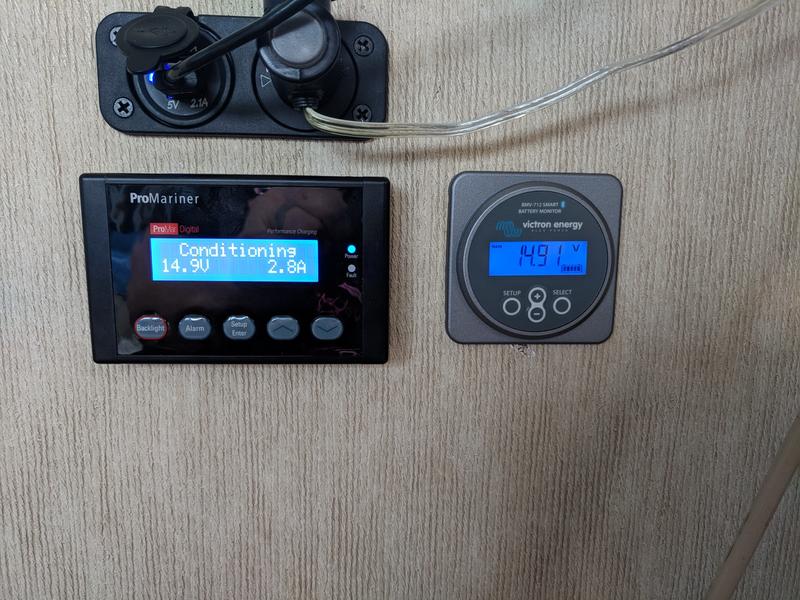

For those with the Trojan's and the Vic monitor, what are you setting you charged voltage too?
