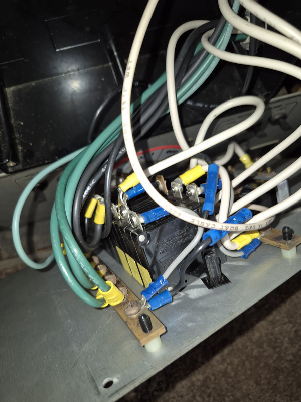

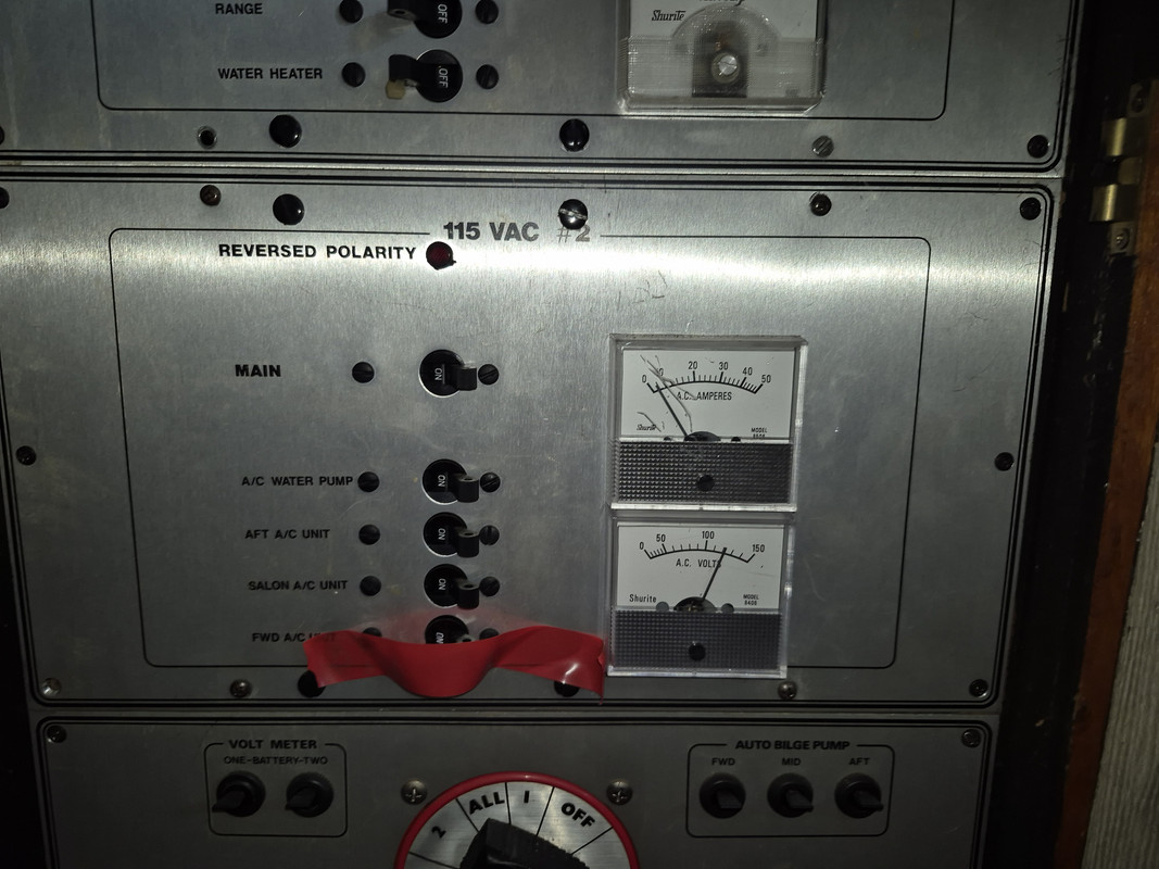

Postby AC3207 » June 25th, 2025, 7:39 pm
I have not been able to find any circuit breakers on the generator or in the manual. Its a Kohler 7.5R27, would the generator breakers be in a separate location from the gen or the main panel? I have pulled the panel and looked at the Main breaker for circuit 2. Its a 3 slot (not sure what you really call it) breaker with the switch in the middle, in the photo its has the three yellow stickers it. I have searched online and cannot find similar breakers with three slots like this one. I may be confused on them being one piece. They have a screw that runs through them and holds them together. See photos. Image Image

Postby km1125 » June 26th, 2025, 11:26 am
The main "3 slot (not sure what you really call it) breaker with the switch in the middle" is a reverse-polarity-sensing breaker which will trip (or not engage) if it senses a reverse-polarity issue.
What do you use to switch from generator power to shore power? Is it automatic or do you have some kind of manual switch?
I don't know that generator model, but several models will have their main breaker in a different spot than the controls. I just quickly looked at a manual for that genset online and don't see any indications of it having a breaker on the generator.
If the generator is still supplying power to circuit #1 while circuit #2 is out, then it wouldn't be a main breaker on the generator. The problem would be wherever you switch from shore power to genset power. That could be a manual switch or it could be some automatic relays.

Here are my thoughts FWIW, my boat does have an automatic transfer switch and you can hear a chatter when the switch does its thing, switching from shore to genset or back to shore. All automatic, I don’t have to do a thing, but I do have a somewhat newer Carver where the auto switches are standard equipment. Older Carver’s like the OP’s as well as the late 80’s 3807 I used to have all have manual switches. Maybe the auto switch was an option back in the 80’s or maybe a PO made the change himself
km1125
Posts: 3656
Joined: February 28th, 2017, 6:04 pm
Has thanked: 80 times
Been thanked: 1113 times
Re: A/C circuit only works on Shorepower
Postby km1125 » June 28th, 2025, 6:48 pm
Yea, the 356's have a separate auto transfer switch behind the main electrical panel.
I believe the OP has the genset with an auto-transfer function. I did see some wiring info in the manual about that, but not enough info on exactly where the relays were located. There should be two sets of relays - one for "Circuit 1" and one for "Circuit 2" (similar to how the 356 is setup). I'd bet the one relay for "Circuit 2" has burned contacts.
